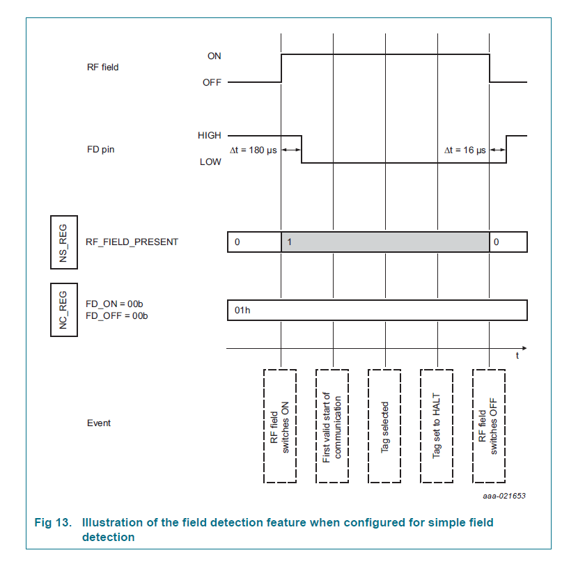

Kan_Li
Hi Leon,
You may set FD pin for simple field detection and probe this pin during the transfer.
Kan

Kan_Li
Hello Leon,
FD pin is open drain type, so you have to add a pull-up on this pin as below:
did you implement like that? Please kindly clarify.
Thanks for your patience!
Kan

leon_wu
Hi Kan,
Yes, the FD pin is pulled up.
