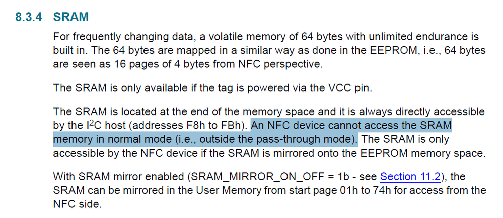

I'm using pass-through mode to transfer file via NFC. It works most of time. But from time to time the RF side can't access the NFC (not even able to read session register). I2C side still works as expected. The value of NC_REG is 0x7d (PTHRU_ON_OFF = 1, FD_OFF=11, FD_ON=11, TRANSFER_DIR=1,NFC_TO_I2C). NS_REG is 0x21 (RF_LOCKED=1, RF_FIELD_PRESENT=1). It can recover after detach and re-attach the reader. Is there anyway to recover it from NFC or I2C side. switching VCC off and on can't fix it.  Please help.

Referring to the spec, pass-through mode is not disabled during transfer, please refer to the following for details.
Maybe that is why NFC side lost the communication.
You may refer to https://www.nxp.com/docs/en/application-note/AN11579.pdf  for more details.

I understand that the pass-through mode needs to be enabled during the transfer.  The pass-through mode is only disabled when I change the direction of transfer and it is enabled immediately afterwards. The section 4.2 of the application note has the following description:
The I²C side either can poll on the bit SRAM_RF_READY in the registers or listen on the FD pin to get low. Afterwards it can either write new data in the SRAM or switch the data flow direction via turning the pass-through mode off first, switch the direction and then turn it on again.

Actually you need not switch the direction manually, when the last page in the SRAM was read/written, the NTAG I²C plus arbiter automatically switches the communication side. but did you just update part of the SRAM and then switch the direction? Is that your case? Please kindly clarify.

RF side writes a message of 64 bytes into SRAM. I2c side detects the change of fd pin and reads the 64 bytes (after the last page is written by  RF side, i2c can read).  Because I2c side read the last page of SRAM, the RF side again has the ownership. If I want to write a reply message from the I2C side, I believe I need to change direction. Thanks

Yes, direction should be changed in that case, but you have to make sure RF side knows how to handle this, you know, the NFC reader may have NAKs during the direction switching, and if the reader thinks it is an error and quit the session, the connection will be lost as well.
