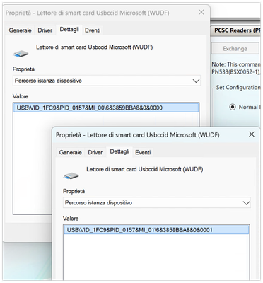

We just bought a CLRD730 and installed the RFIDDiscover v5.6.0.0 an a Windows 11 machine.
The problem is RFIDDiscover cannot find the reader presence, both for the CL and the CT.
These are the devices in the device manager

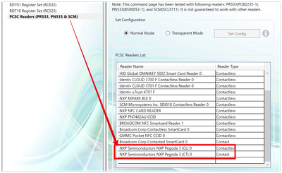

This is what happens when I click the "Get available readers" button in the New Profile dialog.
I tried all the four cases: with/without a SAM inserted in the slot and with/without a DESFIRE card over the CL.
I'va also added the two names in the PCSC Readers list as stated in 3.3 of "UG10039
CLRD730 Quick start guide" Rev. 1.2 — 9 September 2024 https://www.nxp.com/docs/en/user-guide/UG10039.pdf, but nothing changes.
