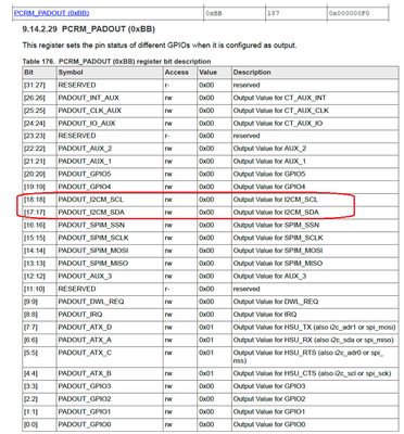

i got two problems using the #PN7642 (Dev Kit) with MCUXpresso (v24.12.148, SDK version 2.12.5)
First one is, that i´m not able to use kGPIO_I2CM_SDA and kGPIO_I2CM_SCL Pins as Output pins. Trying to set them high results in 0,5 V level.
I tried SPIM pins as Output and this was no problem.
Second one is, that i cannot see the Register values using Peripheral+ view. When I stop the Controller in debug mode, all Registers are red. Only Timer Component shows me some values. What could cause this?

KaiLi
Hello @MPEngineering
You should configure the register PCRM_PADOUT (0xBB) to set SDA/SCL as general GPIO, and then these two pins can be configured to have a high or low output.
