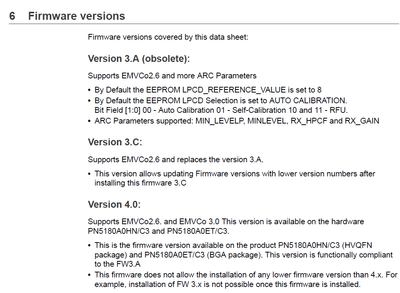

Hi Marcin:
I would suggest you check the differences between version 3.5 and version 4.0.
The differences are listed on PN5180 datasheet.
If some parameters modified , and you can use cockpit to adjust the relevant settings.
Here is an application note about dynamic power control.
https://www.nxp.com/docs/en/application-note/AN11742.pdf

But we are running the same tests with the chips already received with firmware 4.0 not upgraded by us to 4.0 so I believe all DPC settings are already adopted to this firmware.
Anything else to check ?
