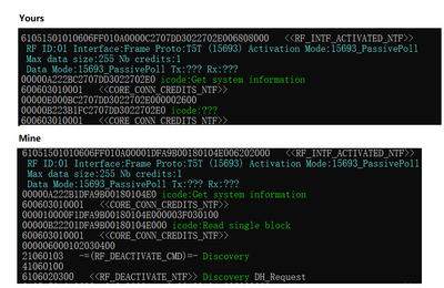

KaiLi
Hello @jschmuc
From the log you provided, it seems that the tag that you used is not the standard 15693, or is not an NXP product at least, so it is recommended that you test it  again with NXP's ICODE tag. The following log compares between me and you for reference.
