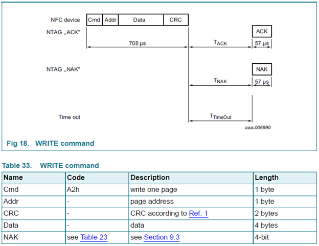

I tried to set the tag213 password protection with ACR122U. Here are the commands listed below.
Step 1  Set PWD:       FF D6 00 2B 04 31 32 33 34 , set password ‘1234’
Step 2  Set PACK:      FF D6 00 2C 04 00 00 00 00, 2byte PACK and 2 byte RFUI set to 00
Step 3  Set AUTH0:   FF D6 00 29 04 04 00 00 00 ,the default value is 04 00 00 FF, with password protection disabled.

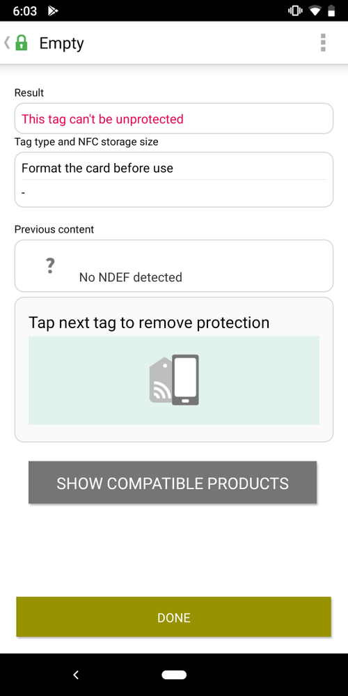

After doing above steps, tag213 shows that the password is protected, but when I tried to remove the password with NFC Tools Pro, an android app, I was prompted to fail.
Is the password format incorrect? I checked the ACCESS byte in CFG1(Page2A) and it has a value of 0 .
Can anyone help me solve this problem?Thanks.#
2,821 Views
nxf54945
Hi gqlei@taisingind.com,
I hope you are doing well.
I checked the commands that you are using and I found that they do not follow the command structure that NTAGs can understand.
For example, in order to set a password upon a new NTAG213 you must write the password into the PWD page of the TAG’s internal memory. To do so, you need to use a WRITE command, which is structured as it follows:
You can consult command IDs and structures on the NTAG21x datasheet: https://www.nxp.com/docs/en/data-sheet/NTAG213_215_216.pdf
So, in order to set the password 31323334h, you should send A2h + 2Bh + 31323334h + CRC

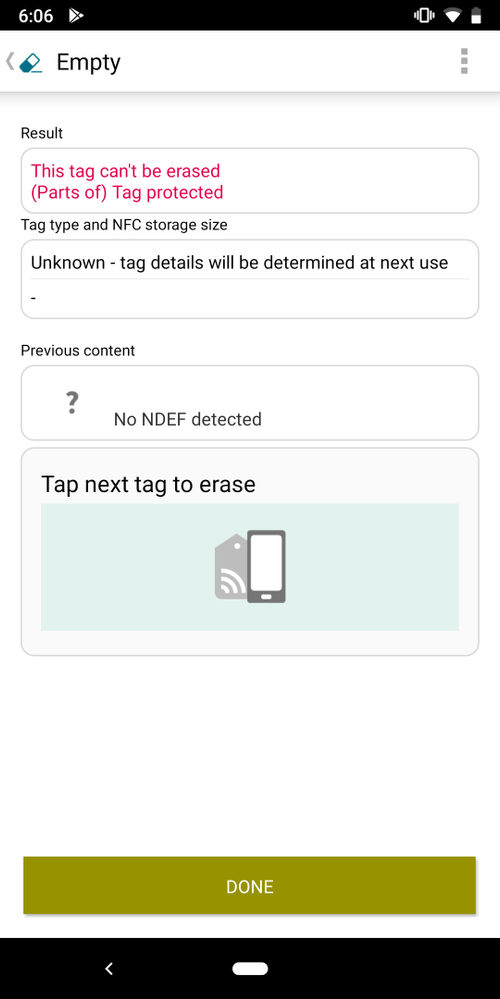

I confirmed your problem or our App Tag Writter. Here are the messages displayed when trying to lift protection or erase Tag:
Could you please give me more details on which android version are you running?
