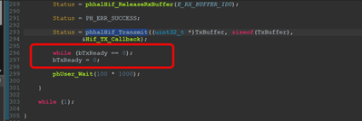

After the "phhalHif_Transmit" function you could consider adding the following lines in order to wait for the transmission to be complete before starting the next iteration.

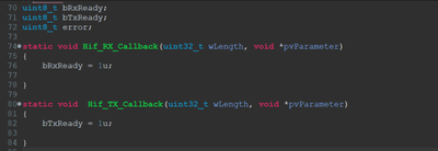

Please note that in my case the Rx/Tx Callbacks look like this in order to handle the Rx/Tx flags.

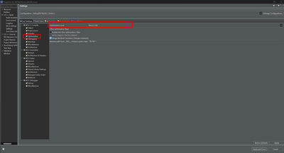

I would also like to mention that at first, I did experience some unexpected behavior regarding the Rx interruptions as well as an error in the transmission. These issues were solved by deoptimizing the compiler for the project. This is done by right clicking on the project and selecting Properties > C/C++ Build > Settings > Optimization > Optimization Level > None.

So first: Yes, my Hif Configuration takes place in the function initUart() and calls phhalHif_Init() at the end. So the phhalHif_InitRxBuffer will be executed after phhalHif_Init().  I also added the bTxReady flag in my TxCallback function to make sure the code only continues when Tx is done. When Tx is done i get an Interrupt with dwStatus = 17 or sometimes dwStatus = 16 (which would be expected) and immediately after an Interrupt with dwStatus = 1(I dont hop in the Hif_Generic_Callback). So the Transmition also triggers an Rx Interrupt. The deoptimizing of the Compiler didnt help me with this problem.
