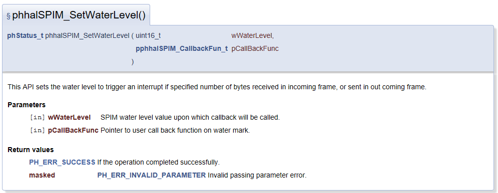

i am working on PN7462  NFC based Microcontroller.
I am using PNEV7462C development kit .
I need SPI master for one of my application.
i am able to transmit multiple data via MOSI to the slave device using the HAL driver function
but my issue is with Receiving data via MISO .
there is HAL function for it , but my application needs it in interrupt form, that is when i receive data  ISR for receive data should be called.
There is this  concept of water level interrupt which is bit confusing .Can any one help me to figure out the water level interrupts ? how can it be used for receive SPI data?

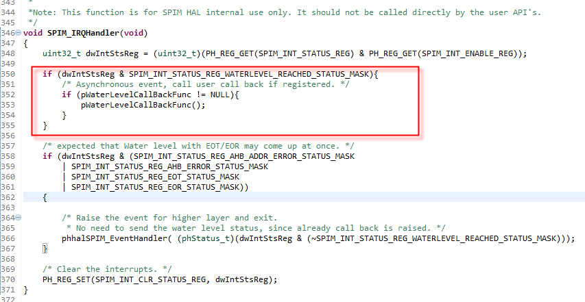

Kan_Li
Hello Sanath Rai,
The API guide has details regarding this topic, please refer to the following for details.
and if the expected number of data is received or sent, the ISR will call the callback function as below:
you may put the data reception function in this callback, but we don't recommend doing that, as it might affect timing of other tasks, and if you insist on that, please keep the code as short as possible.
Hope that helps,
Kan

Kan_Li
Hello Sanath Rai,
Actually the callback is trigger when number of bytes are received or sent, so for your case, you need something to trigger the callback, though I am not sure the details of your application, just for instance, if there are 2 bytes sent out before 6 bytes  received, you should set the water level to 2 before calling phhalSPIM_Transmit(), and after 2 bytes sent out, the callback function will be triggered.
Hope that makes sense,
Kan

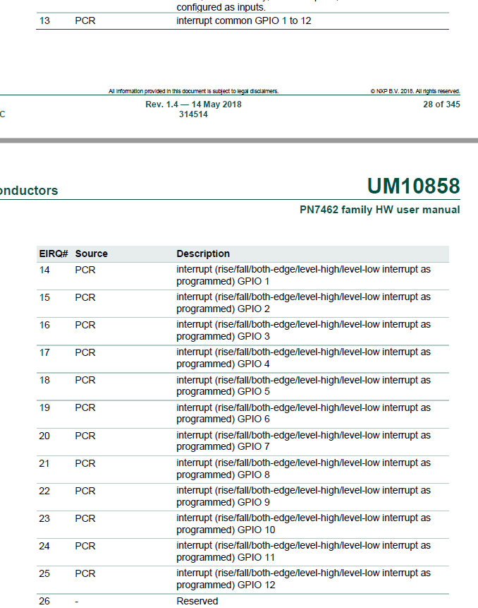

Which document has the information about external interrupts of PN7462? and also are there any drivers written for external interrupts in example libraries?
so that i will use a GPIO pin for external interrupt to indicate the incoming  data from slave side.
Sanath Rai
7,446 Views
Kan_Li
Hi Sanath Rai,
PN7462 has enough GPIO interrupt resources , please refer to the following for details. You also may refer to 8.6 I/O Pad Management in UM10858 for more details.
and you may find GPIO drivers in the hal folder as shown below:
Hope that helps,
Kan

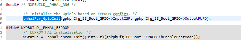

sanath_rai
Hello Kan,
Thank you for the guidance.
i can configure the GPIO as external interrupts .but i could not find the callback(ISR) for it.
am i missing something.Or do i need to use PCR init and PCR call back function(phhalPcr_RegCallBack) for it?
below are the functions used for configuring
phStatus_t phhalPcr_ConfigInput();
phStatus_t phhalPcr_ConfigPuPd();
Sanath Rai

Kan_Li
Hi Sanath Rai,
Actually phhalPcr_GpioInit() is enough to setup the GPIOs, and it is done out of POR.
You may just modify the EEPROM configurations referring to UM10948
and GPIO ISRs are referred in phFlashBoot_VT.c.
You may define the ISR as others, for example, SPIM_IRQHandler().
Hope that helps,
Kan

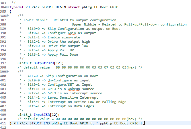

sanath_rai
Hello Kan,
That's a Good function to Initialize the GPIO as input/output and as interrupts.
So i can initialize any of the GPIO's 1-12 as interrupt source using  phhalPcr_GpioInit() .I understood the  function.
But can you please elaborate on the configuration part InputISR[12] and OutputPUPD[12] .
i am bit confused there.Sorry for the trouble.
Thank You
Sanath Rai

Kan_Li
Hi Sanath Rai,
Please refer to the following for details.
Hope that helps,
Kan
7,445 Views
sanath_rai
Hi Kan,
Thank you for the support.
I understood the configuration. I will work on it.
Thanks And regards,
