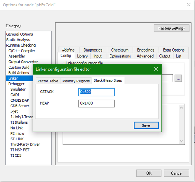

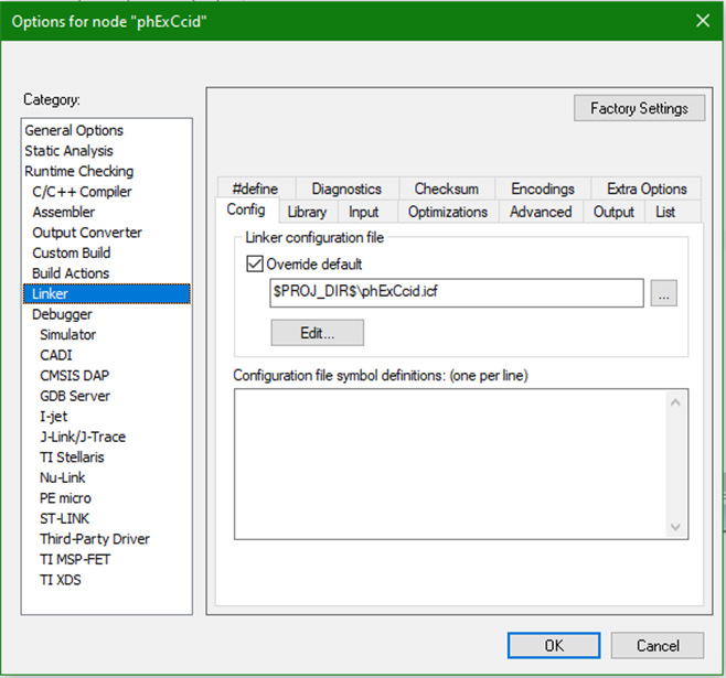

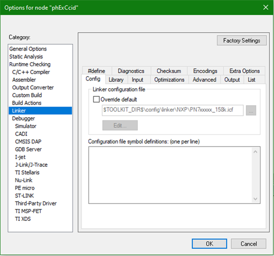

  1. Change the link configuration file with new Stack/Heap Sizes.
  2.  a    In Project options follow bellow steps :danielchen_0-1682057752319.png
Save .icf file in project location.

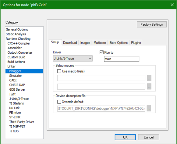

Change Debugger Run To Option to main as shown below

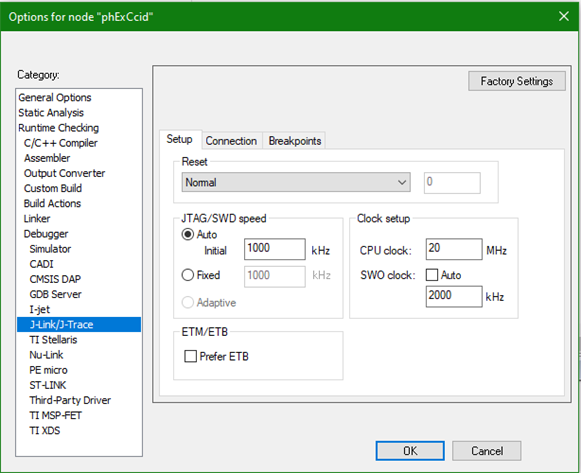

JLink Rest option to be set to Normal as below

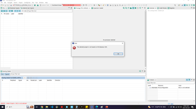

Additionally, if I use MCUXpresso, I can't check the settings of the project on the pin settings page.
Can't you check it out?
The build is normal, but the pin setup page displays the error "The selected project is not based on MCUXpresso SDK". Is there any way to get a normal SDK? Please check.

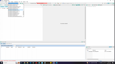

Compiling is normal, but I can't check the pin setting of the MCU as shown in the picture below.
Can't you check the contents of the pin setting of the MCU?
I want to check how you set it up in the SDK provided.
I would appreciate it if you could check and change the PIN settings on the development board.
Thank you.
6,221 Views
danielchen
Hi @JY2 :
Currently the config tool supports i.MX RT,  Kinetis, LPC,  PN76.  unfortunately not support PN74.
For PN74, you need to manually config.

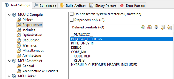

From what I can see from the source code , the preprocessor defined symbols are "PH_OSAL_FREERTOS" and  "PH_OSAL_NULLOS" (phOsal_Config.h)
But I am not sure that every demo can work with both FreeRTOS and NULLOS.  maybe some demos can.
5,947 Views
JY2
Hi, @danielchen
I use the 7.07 version of the source code that you told me.
I changed "PH_OSAL_FREERTOS" to "PH_OSAL_NULLOS" in the project-Properties-MCUC Compiler-Preprocessor as shown in the screen you captured. However, the source code is not built.
The 298th line of the file "phRtos_NoRtos.c"
"__phUser_EnterCriticalSection();" C:/workspace/NXP/SW368332/Platform/PN7462AU/phRtos/src/phRtos_NoRtos.c:298: multiple definition of `SysTick_Handler'; ./phOsal/src/NullOs/portable/phOsal_Port_PN74xxxx.o:C:/workspace/NXP/SW368332/RTOS/phOsal/src/NullOs/portable/phOsal_Port_PN74xxxx.An error message such as c:156: first defined here is output.
It may not work normally if I modify it to my mind. Does this SDK not support NO_RTOS mode?

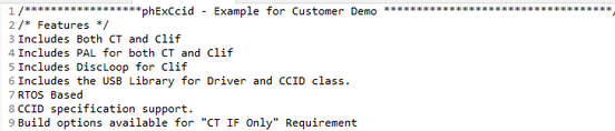

May I know why you need this demo with NULLOS,  because it does not make sense with NULLOS , this demo involved USB task, clif task, CT task and maybe other tasks.

danielchen
@JY2
This demo is RTOS based, you can see this info from readme file.
