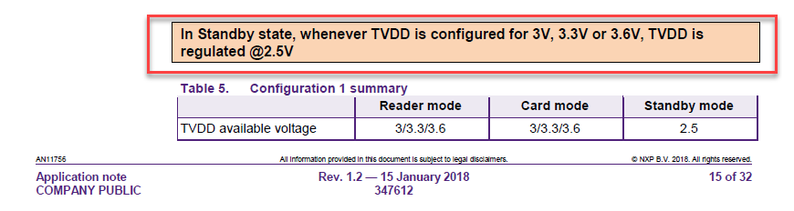

Besides,Customer test voltage of 7150 when the device power off. The result is VDD(MID)=0.844V,VDD=1.8V,VDD(TX)=2.49V,meanwhile VEN=0V,VDD(PAD)=0V,VBAT=3.6V. It looks like PN7150 internal LDO is on default. Is this right?
1,723 Views
Kan_Li
Hi @bob_zhang ,
What does " the device power off" mean here with VBAT=3.6V? Seems PN7150 is in standby mode as VDD(TX) is around 2.5V. Please kindly refer to the following for more details.
