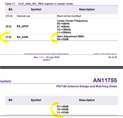

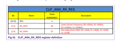

The issue is most probably caused by a noise on the Rx lines -> very high Rx Gain -> The noise generates "60 07 01 a1".
The solution would be an adjustment of the CLIF_ANA_RX_ REG register -> PN7150 Antenna Design and Matching Guide -> 5.5.3
I would suggest decreasing Rx gain for ISO 15693. So, let's try 40dB (01) -> 0xA0, 0x0D, 0x04, 0x22, 0x44, 0x21, 0x00
Let us know if this helps, please.

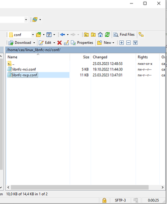

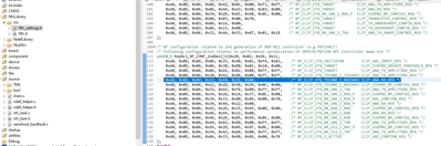

Hi Tomas, could you be more specific on where I can find the file Nfc_settings.h? Because I can't find it both on the Linux libnfc library or the NfcFactoryTestApp, the same used by CamelCaser.
Thank you
4,100 Views
Tomas_Parizek
Hello mattiandorigo,
If you use MCUXpresso, you can find it here:
For Linux (e.g. Raspberry Pi ), you can find the configuration file here -> "Your folder" ->linux_libnfc-nci/conf/libnfc-nxp.conf
Tomas
