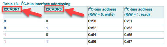

On manual i see that default address for PN7150 is 0x56, 0x57, but on my implementation when i run i2cdetect , i find it on 0x7c. Is this correct?

There is no way to set the PN7150 I2C address other than 0x28, 0x29, 0x2a or 0x2b (7 bits address as it should appear in i2cdetect tool) depending to PN7150 I2CADR0 and I2CADR1 pins level. This is confirmed by HW design.
To my mind, address 0x7C reported in i2cdetect tool doesn't relates to PN7150 but rather to another device connected on this BUS.
Pay attention that PN7150 will not acknowledge its I2C address (not seen on i2cdetect tool) until VEN pin is set to HIGH level. So make sure to properly drive it by GPIO or connect it directly to 3.3V level.

IvanRuiz
The I2C address is defined by I2CADR1 and I2CADR0, please verify the state of these pins. Depending on their value, they may take the following addresses:
Importantly! The I2C Address will change depending if reading or writing (least significant bit).
Hope this helps.
