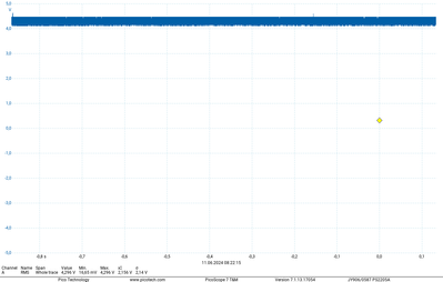

Tomas_Parizek
Hello gwctree42,
I tried to reproduce it with PN7150 dev. board with the following results:
CFG2 -> 0x06, 0x64, 0x00
VDD(TX) without a card in the proximity
VDD(TX) with the card in the proximity
CFG2 -> 0x06, 0x64, 0x01
About the waveform, it might be that you coupled some RF signal during your measurement. Can you share some scope measurements ?
About the meaning of byte2, this I need to check internally. These statements/recommendations are typically coming from RnD team.
Tomas

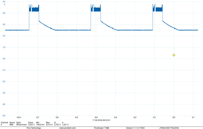

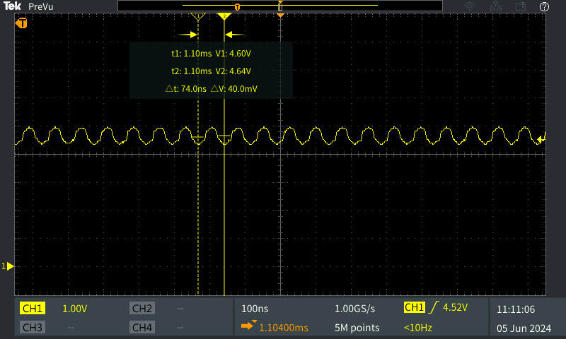

gwctree42
This is 0x6 0x64 0x0 with no card present. The 2nd pic is just zoom in just after the rising edge of VDD(TX).
Looks like it behaves as expected with byte2=1 for you. Not sure what is different for me. Would be good to know if there is any downside to leaving byte2=0.
