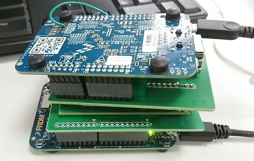

I am using two frdm-k64f Each connected to an NFC controller "pn7150",
And I want to make the connection between them in peer to peer active mode,

It is easy to play the P2P demo, please following the following steps:
1. download demo code into two FRDM-K64Fs via KDS:
2. put these two FRDM-K64Fs like below:

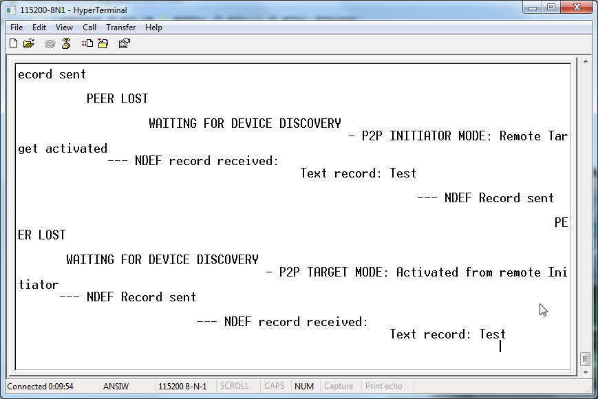

3. you may see the echo messages from the HyperTerminal :
