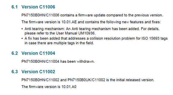

When initializing PN71506 version chip and PN71501 version chip with the same code
It is confirmed that the I2C communication READ TIME of PN71501 version chip takes a little longer.
(The 06 version is read for 30ms, while the 01 version is not read for 30ms, causing an error in the same code. The 01 version is read if you change the READ TIME to 40ms).
Is there any difference between versions regarding I2C communication interval ?
I would be grateful if you could also let me know the minimum communication interval when communicating with i2c 400kHz.

Hi @welpo :
Please note that PN7150 is not recommended for new designs,   The replacement for this product is the PN7160, please refer to below link for more details.
https://www.nxp.com/products/rfid-nfc/nfc-hf/nfc-readers/nfc-plug-and-play-controller-with-integrate...
For the difference between 71501 and 71506, please refer to below picture
PN71501 is the initial released version.  The firmware version is 10.01.A0
PN71506 is the latest version, The firmware version is 10.01.AE.
