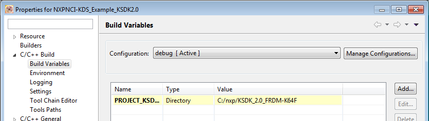

I downloaded the Demo Code SW3735 (dated Aug.30th.2016) and tried to run this on a KINETIS FRDM-K64F board.
I did follow the instructions as of AN11845 but the KINETIS 2.0 Compiler did not compile the sources wit 1bout 135 Error Messages. Screenshot attached)
How can I get this working.
Peter
7 Replies
15,460 Views
Jorge_Gonzalez
Hello Peter Furtner,
Did you set the "PROJECT_KSDK_PATH" variable using slash ( / ) and not backslash ( \ ) as instructed in the user guide?
See below picture, in my case my path is [ C:/nxp/KSDK_2.0_FRDM-K64F ].
I hope this helps.
Let me know if you still have issues with the project.
Regards!
Jorge Gonzalez
