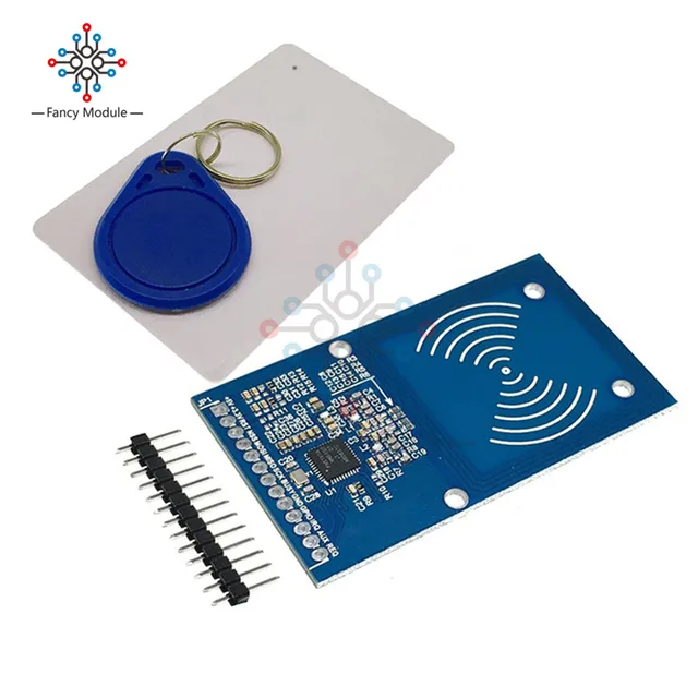

Additionally I would like to add that I'm testing using following shield.
The chip has following number: PN5180A. The FW version is 3.5. The EEPROM version is 00 91.
The NXP PNEV5180B V2.0 Evaluation Board has a chip with following number: PN518C3The FW version is 4.0. The EEPROM version is 00 99.

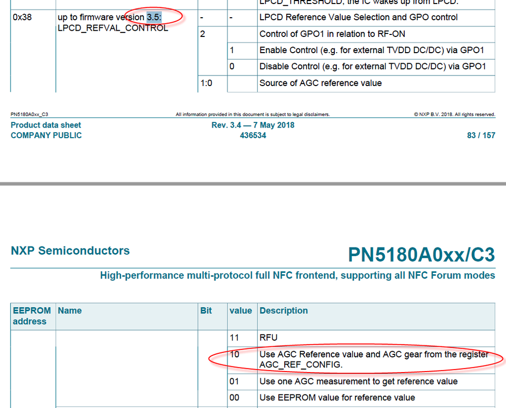

Using LPCD EEConfig Self_Calibration I noticed it would write value 0x01 into registers 0x38 (LPCD Ref Value Selection). Still, the PN5180 datasheet clearly mentions that value 0x01 is autocalibration using RF_Checkcard function). Is this a bug in NFC Cockpit? Applying Auto_calibration via Update EEPROM Config would also write the wrong values into the 0x34 EEPROM address. For example selecting Gear 15 would program 0x34 as 0x0F and 0x35 as 0x00. Though the PN5180 datasheet mentions that 9:0 are AGC reference value where bit 13:10 are AGC gear.  (read below)
Using LPCD EEConfig Auto_Calibration I noticed it would write value 0x00 into registers 0x38 (LPCD Ref Value  Selection). Still, the PN5180 datasheet clearly mentions that value 0x00 selects the EEPROM reference value. Is this a bug in NFC Cockpit? And why doesn't it write the AGC Value into EEPROM, but only the gear?  (read below)
And what about LPCD Ref Value Selection 0x02? That seems to be missing in NFC Cockpit, though "Write AGCREF_CONFIG register" actually does exactly that (though only for the gears)! (read below)

It seems there are quite some differences between older chips with older firmware, and newer chips which run the latest firmware.
For instance EEPROM address: LPCD_REFERENCE_VALUE (0x34)
  • PN5180A0xx-C1-C2, fw 3.5:
    2 bytes: bit 9:0 AGC reference value; bit 13:10 AGC gear
  • PN5180A0xx-C3, fw 4.0:
    2 bytes: bit 15:4 RFU; bit 3:0 AGC gear
    so NFC Cockpit was reading/writing that address correctly
And also EEPROM address LPCD_REFVAL_CONTROL aka LPCD_REFVAL_GPO_CONTROL (0x38)
  •  PN5180A0xx-C1-C2, fw <= 3.5:
    LPCD_REFVAL_CONTROL
    1 byte: bit 1:0 Defines the source of the LPCD reference value
    00b Use EEPROM value for reference value
    01b Use one AGC measurement to get reference value
    10b Use AGC Reference value and AGC gear from the register AGC_REF_CONFIG. Though on page 50 it says: Use the Register value of CHECK_CARD_RESULT for reference value. This allows the configuration of the reference value without EEPROM programming.
    11b RFU
  • PN5180A0xx-C1-C2, fw > 3.6:
    11b RFU
  • PN5180A0xx-C3, fw 3.A:
    LPCD_REFVAL_CONTROL
    11b RFU

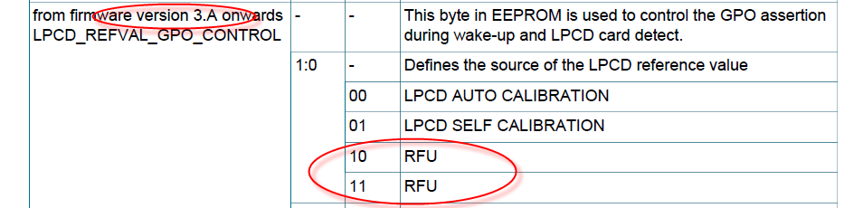

    00b LPCD AUTO CALIBRATION
    01b LPCD SELF CALIBRATION
    10b RFU
    11b RFU
    this explains why NFC cockpit only shows these modes for the NXP PNEV5180B V2.0 Evaluation Board
For register CECK_CARD_RESULT aka AGC_REF_CONFIG (0x26):
   reading => perform a check card routine
   writing => uses the register value as LPCD reference when LPCD mode is 2.
   the behavior is the same across all datasheet / fw, though note that PN5180A0xx-C3, fw 4.0 doesn't support LPCD mode 2, it's RFU.
   doesn't explain why the write-read cycle that I'm trying to accomplish doesn't work on PN5180A0xx-C1-C2, fw 3.5, but does work on PN5180A0xx-C3, fw 4.0.
3,411 Views
Kan_Li
There is something inconsistent with data sheet of PN5180A0XX-C3.
