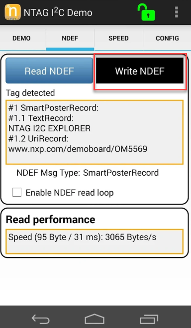

I'am testing OM5569/NT322ER NTAG I2C plus Explorer Kit.
The application demo works fine with a smartphone Androïd.
Is this demo kit can be used to generate a RF field and then transfer data to my sensor (another tag) as a writer and not as a reader ?
If the answer is no (what I fear), which solution take ?
My sensor will be a LPC8N04 or NT3H2211.
Thanks for your help.
David

The NTAG I2C Demo App is capable of reading from and writing to the NTAG I2C (NDEF tab) as shown in the image below:
For more information regarding the App, please visit: NTAG I2C Demoboard - Apps on Google Play
