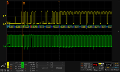

Libaiyi
This is a Configuration memory with a starting address of 1000h.
The data captured here corresponds to the data that can be read by mobile app
This is a session register with a starting address of 10A0h, all  value is 0xff.

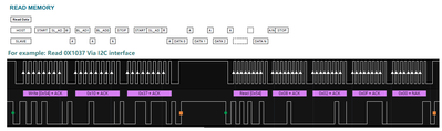

Hello @Libaiyi
From the I2C timing logic of your side, the reading the logic of the register is not correct. NTAG5 has two type of reading, one is to read the entire field of the register that is 4 bytes, the other is to read any field of the register, please refer to the following example to adjust your read logic.
