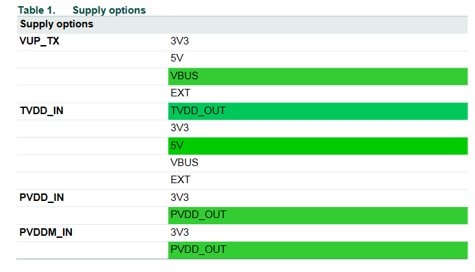

I'm reading PN7462 datasheet but I'm not sure I can digest it in a way to properly design my board. Would you guys be so kind to help me with the following:
1. How to supply the PN7462 module? Which power pins do I need to connect to power supply? How to achieve 1.8V for UART and GPIOs?
2. How to download the firmware on PN7462? Using SWD interface ?
3. How to properly design the antenna circuit for NFC communication. Is there any antenna chip available on the market or I need to print it on a PCB?
-PVDD is used for pad voltage reference and supply of the host interface (HSU, USB, I2C, and SPI) and the GPIOs. so if you use PNEV7462B , you may connect PVDD to an external power, please also note in such kind of case, If PVDD is externally supplied,  the Jumper 42 (PVDD_OUT) needs to be set. By setting  this Jumper the PVDD_OUT is shorted to GND and the PN7462AU turns off the PVDD  LDO.
