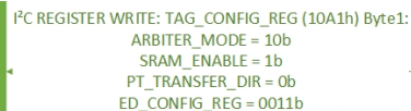

Daniel_Gutierrez
Hello @tedarcpicker, Good Day!
For a proper implementation of the pass-through mode please ensure the following configuration of the session registers is being handled correctly by the MCU before writing to the SRAM for the first time:
Consider that the ED pin has to be used in this mode since a logic LOW state on this pin will let the MCU know that it can write again to the SRAM. Additionally, note that any delays will interfere with the flow of the pass-through mode, I would strongly recommend to constantly read the configuration registers from the NFC side with the READ_CONFIG_REG command (A0h) to check SRAM_DATA_READY == 1.
Please consider that a 300Hz frequency on the I2C side would lead to a relatively slow communication speed.
To increase the data rate in this mode, please increase the I2C frequency to around 100kHz for standard mode.
