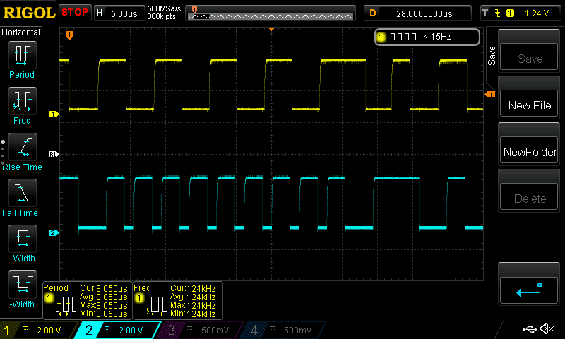

I am working on  NTAG I2C. plus 2k version
I  Could read/ write to the NFC chip through the host microcontroller and a NFC device.
Now all of sudden the I can neither read nor write into the NFC chip through I2C from the host MCU, but I can read/ write NDEF mesages through my mobile phone (NFC device). I can also read registers using the NXP Android app.
I check the I2C pin, everything is correct.
Can someone please tell me whats going on here?

I think I found the Problem. It seems like the reset button of the ntag demo app is Setting the slave address of the tag to 0.

Can the I2C host access the register in the tag? for example, the session register.
Kan
2,278件の閲覧回数
kaibuechler
no I cannot access seassion or config registers. I'm geting a NACK after sending the NTAG address and a 0 for writing.
I can read the seassion and config registers over nfc, but writing the config registers fails (with the nxp nfc demo app).
Like I've said before, a new chip works for a while, but they'll  start to act weird sooner or later (all 4 chips usesd are from the same reel).

Hey,
I'm having the exact same problem! I already killed 4 of these tags in a row. Reading worked fine for a few weeks (I was developing other stuff meanwhile but a reading of the config Register after every reset was implemented), than I started to write to the tag (over I2C) and the chip died after a few resets. With the Android app you can still connect, but writing to the config register stopped working in most of the cases.
What I did so far:
I checked the i2c bus with my scope - looks good, no noise, no Spikes.
I checked the supply voltag, steady at 3.3V with Vpp of 30mV
May I ask which mcu you are using? For me it is a EFM8B2.
