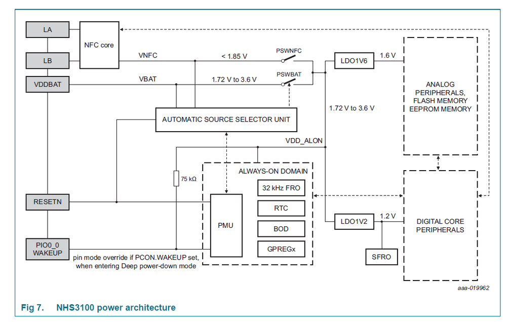

What is the output voltage of the GPIO pins on the NTAG SmartSensor NHS3100 IC when it is NFC field powered?

Hello Cory,
Referring to the data sheet, GPIO is powered by 1.6V.
So I think the output high voltage should be 1.6V as well.
Kan

cory_a_lord
Thanks for looking into that, Kan_Li. I saw that diagram in the datasheet. If that is accurate, it appears there Digital GPIO pins would be 1.2V

cory_a_lord
Thanks for your swift reply, Kan_Li. I appreciate the clarification about the NTAG I2C Plus.
I was looking at the NTAG Smart Sensor ICs for my use case. "Energy Harvesting" works differently with those chips. When the NTAG Smart Sensor is being powered from an NFC field you can power external sensors using a GPIO pin pulled high instead of a dedicated "VOUT" pin, like the NTAG I2C Plus. I read that the GPIO voltage is 1.8V, which would be a problem for my sensor which needs at least 3V. Is there a way to get 3V out of an NTAG Smart Sensor chip when it is field-powered?
