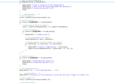

I am trying to test passthrough mode using NTAG-I2C+ dev kit for Arduino (OM23221ARD) to a CLRC663 reader running the SW297859 SDK, but have been unable to get any data written from the CLRC663 to the NTAG's SRAM buffer in passthrough. I've run the NfcrdlibEx9_NTagI2C example in SW297859 and this confirms that pass through is enabled on the NTAG. I've tried updating this block (see attached) to perform an ISO14443 exchange with the NTAG but the SRAM_I2C_READY of the NS_REG never gets set and if I dump the SRAM I don't see anything written. On the CLRC663 side I get a 0x201 error which looks like a timeout on waiting for a response (which makes sense since I don't currently have the NTAG sending anything back until the SRAM_I2C_READY gets set).
Attached is the code change that I made. Can someone please point me the correct direction for performing an ISO14443 exchange with the NTAG? Or is it even possible to perform passthrough exchanges with the CLRC663 running SW297859 SDK since it doesn't support P2P?

Yes the CLRC663 does support Ntag I2C passthrough. The issue is that the example from the NFC Reader Library is only, reading specific pages of the NTAG I2C. Once the passthrough is enabled in the NTAGI2C, the CLRC663 needs to read directly to sector 0, page address 0xF0. As mentioned in section 11.3.1 the use of Fast Read commands are recommended.
Please keep in mind that both interfaces cannot be accessed at the same time and the status registers need to be implemented in your application using NS_REG.
Also, keep in mind that in order to access SRAM is required to power on the device via VCC
Unfortunately, we don't have a specific implementation for this in the Library examples.

I have tried variations of this with no success. For reference on the NTAG is powered from VCC and I can see data get written to SRAM successfully when using the Android NTAG I2C app so I believe my issue is isolated to what I am doing on the CLRC663.
I am using the `./SW297859/Examples/NfcrdlibEx9_NTagI2C` example with the only change to the if block that deals with an NTAG in passthrough:
/* check for Pass-through mode */
if ((bDataBuffer[0] & PTHRU_ON_OFF))
LOG_DEBUG("Writing to NTAG");
uint8_t writeSRAMCmd[] = {0xA6, 0xF0, 0xFF}; // Fast right to Start address of the SRAM block
uint8_t dataToWrite[] = {0xDE, 0xAD, 0xBE, 0xEF}; // Example data
uint8_t sramWrite[sizeof(writeSRAMCmd) + sizeof(dataToWrite)];
memcpy(sramWrite, writeSRAMCmd, sizeof(writeSRAMCmd));
memcpy(sramWrite + sizeof(writeSRAMCmd), dataToWrite, sizeof(dataToWrite));
status = phpalI14443p4_Exchange(pHal, PH_EXCHANGE_DEFAULT, sramWrite, sizeof(sramWrite), NULL, 0);
CHECK_STATUS(status);
From the log statement I can see that we attempt to write something, but nothing shows up on the NTAG. I have tried manually appending a CRC as well as writing a full 64 bytes, but have been unable to get anything written. Could you give sample code of how I can write anything to the SRAM buffer?

Unfortunately, we don't have the specific implementation using phpalI14443p4_Exchange() since the implementation in the Ex9_NTagI2C example is using the MIFARE Ultralight API for performing T2T interfacing, we recommend please adopt this practice as well.
As recommended in the Datasheet, please use the FastRead command. The MfUl does have this function as: phalMful_FastRead()
I'm sure you already have checked SW3647 and SW3648.
But in SW3647, NTAG_I2C_Explorer_Demo is shown in CopyInterruptToSRAM() how we recommend copying the data into the SRAM for the CLRC663 to be able to read the passed values.
In SW3648, there is a file called Ntag_I2C_Demo which shows the implementation for reading into the SRAM. It is required to check if the SRAM is ready before starting to read the actual memory since it could be blocked from the NFC side.

I don't thing there is any issue with my configuration of the NTAG since I can see it working using the NXP Android reference app when I write to the NTAG then read back over I2C. I believe there is something I am missing on the CLRC663 side of things. I have tried phalMful_FastWrite() without success.
Could you provide reference code of using phalMful_FastWrite() that I could use as a starting point?

I can get passthrough working using the NXP sample app for Android (not for iOS) so this implies the NC_REG is set correctly on the NTAG side. What I can't get working is the CLRC663 writing to NTAG via passthrough.
void enablePassThroughRFToI2C() {
// From NFC SDK
// NTAG_SetTransferDir(ntagCoreStateHandle.ntagDriverHandle, RF_TO_I2C);
// ntag.writeRegister(Ntag::NC_REG, NTAG_NC_REG_MASK_PTHRU_ON_OFF, 0);
ntag.writeRegister(Ntag::NC_REG, NTAG_NC_REG_MASK_TRANSFER_DIR, RF_TO_I2C);
ntag.writeRegister(Ntag::NC_REG, NTAG_NC_REG_MASK_PTHRU_ON_OFF, 0x40);
For the CLRC663, as seen in the previous code snippet, I am prepending the APDU with:
uint8_t writeSRAMCmd[] = {0xA6, 0xF0, 0xFF}; // Fast write to Start address of the SRAM block
..but this is not working.
Could you provide sample code snippet for CLRC663 writing to the NTAG SRAM buffer?
