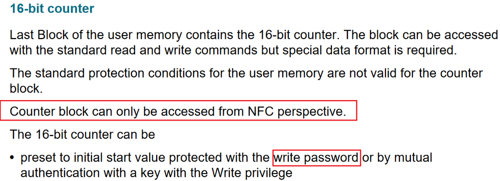

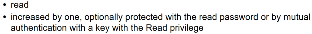

amal
@weidong_sun Do any of the NTAG5 chip types support SUN type counter based cmac signed memory mapped signatures on NFC read? The NTAG424 supports this as well as mutual authentication, however I am hoping there is an ntag5 that suports protecting the i2c data bus with mutual auth, but also allows a simple cmac signed NFC read we can auth with just a browser no special app.
