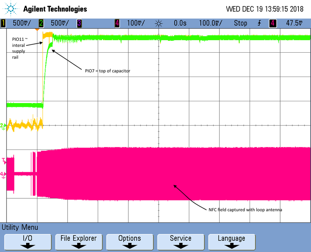

I would like to power the NHS3152 chip only through the NFC field and perform a measurement with it. Unfortunately the measurement seems to consume too much current, so I inserted a capacitor (100µF) between PIO0_7 (high-drive-pin) and ground. Now I want to charge this capacitor through the field first and then use the stored energy of the capacitor plus that of the field to perform a measurement. I have created the following program for this purpose:

However, this does not work yet. I want to read a NDEFT message with a smartphone. Furthermore I noticed while measuring the voltage over the capacitor that it rises to approx. 1.8 Volt. However, not every device seems to have enough power to reach this voltage. My question is whether I have the pins correctly driven or whether I still have other configurations to make.

Hi Tom,
Can you give some more detail? What seems to be working, and what not?
Are you sure the cap is necessary? Can you check the system clock? Did you also check with a scope plot?
When reconfiguring pin 7 as output, all current will flow to the (huge!) capacitor, resulting in a voltage drop to near 0. The code will need to charge the cap slowly.
Via NFC, only 1.8V can be supplied to the IC. Think of the NF controller as a power supply of 1.85V, with a resistance of about 200 ohm in series. The code must make sure the load is not too high, to prevent a too sever voltage drop.

Below a scope plot which shows the steady voltage supply after charging a cap. The small jump on the green graph is when the pins are reconfigured to output. After that, the code is performing several I2D and ADC conversions. pastedImage_1.png
The NHS3152's NFC controller is type 2 compliant. There is no way to pause the NFC communication, or to delay the tag reader's readout of the tag's NFC memory. This means you must prepare an NDEF message as soon as possible.
This means that your passive program cannot make the measurements in time: it must revert to displaying the result of the previous tap.
