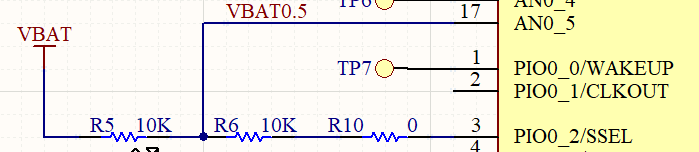

NHS3152 AN0_5 is sitting at ~2.0V without Firmware, yet the data sheet states it is a max 3.6V tolerant Input. In the schematic VBAT is 3V the voltage divider is used to measure the Vbat at its actual voltage within the 1.744V limit to the ADC.

Hello Kelvin,
What do you mean "without firmware"? Did you erase all firmware sectors? In any case, the bootloader must have run.
Assuming you are using the latest SDK - after calling Board_Init() PIO2 will have an internal pulldown (~72kOhm), and the analog pads have an internal pulldown (~47kOhm).
With these typical values there will be ~2.25V at AN0_5 in your schematic. The pad is not clamped to 2V but to VBAT.
Note: in this configuration, current will be continually injected in the IO ring while in Power-off mode. This mode is not supported. If your use case uses the power-off mode, the PIOs should not be tied directly or indirectly to VBAT.

driesmoors
Hi Kelvin,
Connecting RESETN to the same supply as provided to VDDBAT is OK for as long as the battery is present. You will get problems powering via NFC if the battery dies afterwards, however. Best is to not connect RESETN if you do not intend to use it.

kelvin_hasseler
Hi BR:
I have a 0.1uF connected to the RESETN pin on my PCA which is causing the NHS3152 to come up in the active state instead of the power down mode from a Power Off condition. Do you recommend I remove the cap?
I added below yellow state to the power diagram in your “NHS31xx Power modes” power point. You should add the yellow diagram it will really help me understand this PMU unit. I confirmed this behavior with the therapy adherence PCA running the Resistive 13 code.

driesmoors
Hello Kelvin,
If you want, you can change the 100 nF for a 1 nF cap (see also in the datasheet, chapter Static characteristics, "external capacitance on pin RESETN"). This will still provide some ESD protection and will delay startup minimally.

kelvin_hasseler
Hello:
Yes I erased all sectors using the latest LPCExpress tool. It looks like I can not use this circuit to measure VBAT because I will use the power down modes . Does the NHS3152 have a way to measure the VDDBAT voltage without external connections?
