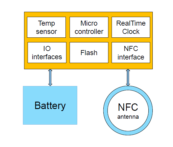

Hi there everybody,
I am new to the community and I am working on the NHS3100. I achieved to read out with an MFRC522 all the RF blocks (it shows me data in block 0x00 to 0x232) and I can distinguish the ID (stored in 0x00 and 0x01). But how do I know where the temperature is?
I have read the datasheet intensively but I can just find that the temperature is in the block 0x4006 0000. But that is not the RF-address.
So my question, in which RF-Block can I find the temperature? (or am I on the totally wrong path?)
Thank you very much for helping out a newbie

Hi Lu,
NHS3100 is not a pure NFC tag, and you may understand it as below:
So you have to send commands to MCU via NFC interface, and MCU may read the Temp sensor or read the saved data in the flash and then response to the remote reader(usually an Android phone or something like that) ,  so in short, both the reader and NHS3100 side should have built-in software for that purpose, and We provide reference on that topic:
Androind App: NHS3100 Temperature Logger APP - Apps on Google Play
NHS3100 firmware: https://www.nxp.com/webapp/Download?colCode=RELEASE-MRA2-NHS3100-11_2&appType=license&Parent_nodeId=...
Please refer to NHS3100 Starter Kit for Temperature Monitoring|NXP  for more details.
