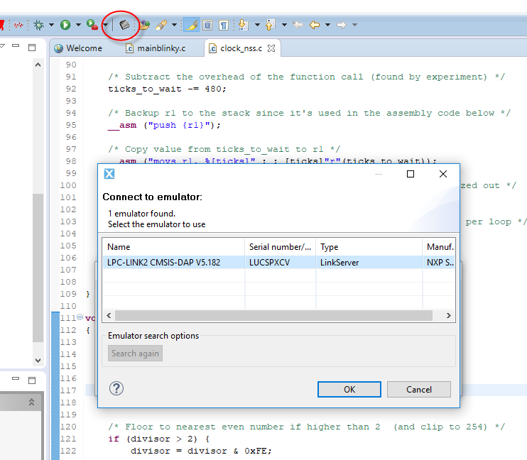

andrewlentvorsk
How do I use the LPC-Link 2 and LPCXpresso v8.2.2_650 in order to recover this?

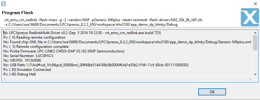

Kan_Li
You may import any project for nhs3100 and mass erase the chip.Please kindly refer to the following for details.
