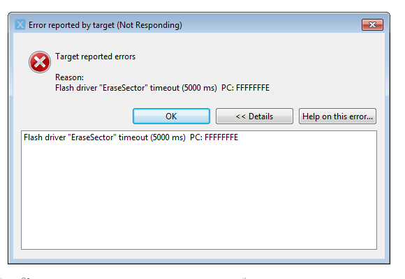

I'm stuck with the following Error message of the LPCXpresso program. Target is a NHS3100 chip. The error appears when trying to flash or debugg the NHS3100 chip.
Right now I'm trying to figure out how to use the low power mode and altered the blinky program:

I would like to be able to flash the NHS3100 again. Help on possible flaws in the code are also appreciated. Thank you for your help.

Hello Till,

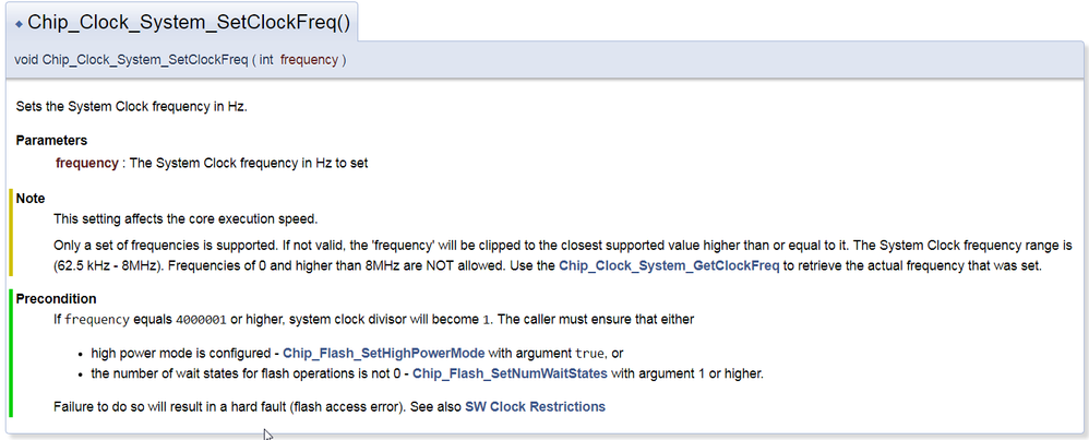

I suspect this line is causing you problems:
Chip_Clock_System_SetClockFreq(8000000);
To operate at 8 Mhz, the low power mode of the FLASH can not be used. You must prior to that call this line of code:
Chip_Flash_SetHighPowerMode(true);
See also the documentation at <SDK>/docs/firmware.html, "SW Clock Restrictions", and the documentation of the API:
If you have flashed a debug version, it should still be easy to recover from this. You best try to use Flash Magic to flash it with some other firmware. If you have flashed a release version, then I fear the IC may have been bricked: the SWD lines are inaccessible before main gets control, and main causes a hard fault almost immediately. The only way out is then to replace the IC, I'm sorry to say.
