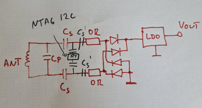

But if your design requires NFC communication, you can extend the energy-harvesting circuit with the NTAG I2C as shown below:

ZHELI1
Hello Tomas,
Yes, I am using a mobile phone for reading. Hello, I would like to ask, in this diagram, is Cp used for resonance? Then what is Cs used for (energy storage?)? And is this 0-ohm resistor used for a jumper? I tested this device yesterday. After the antenna and capacitor resonated and matched, I aligned the mobile phone NFC with the coil, and then connected the output to a small LED light. This small light intermittently lights up, and the brightness is not high, not even as high as the energy provided by the NFC chip (10mW).

Hello ZHELI1,
You have to tuned the NFC antenna  using CP and CS to approx 13.56 MHz. For that, the Vector Network analyzer has to be used.
Cp defines the resonance frequency and Cs the system Q factor. The 0-resistors are just for disconecting the rectifier. This might be good for the development phase.
