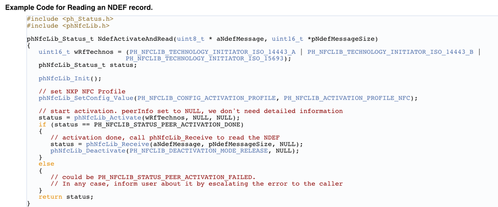

So I have a problem with NXP NFC Reader Library(v4.040.05.011646)... NFC profile is not implemented. Can someone please tell me where I can find final version?

Hi Ivan,
I'm reffering to PH_NFCLIB_ACTIVATION_PROFILE_NFC:
/** NFC Forum Activation Loop Profile and NDEF communication channel
 *  \warning NFC Profile is not implementend/available in this release.
#define PH_NFCLIB_ACTIVATION_PROFILE_NFC             0x0U
/** EMVCo Activation Loop Profile and ISO14443-4 communication channel */
#define PH_NFCLIB_ACTIVATION_PROFILE_EMVCO           0x1U
/** Generic ISO Activation Loop Profile and block/frame oriented communication
 * channel (depending on underlying protocol)  */
#define PH_NFCLIB_ACTIVATION_PROFILE_ISO
there is even sample code in documentation...

I have EXPLORE-NFC board and I tried working with NFC Reader Library for PN512/NFC Reader Library for Linux both 4.040.05.011646 version. I downloaded them from NFC Reader Library - Software support for NFC Frontend solutions.
Looks like v05.16.00(PN5180) is also missing NFC Profile.
