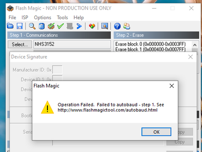

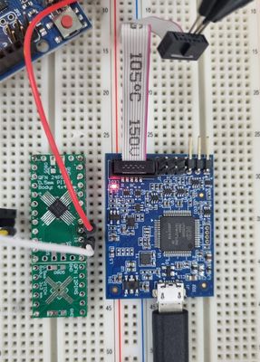

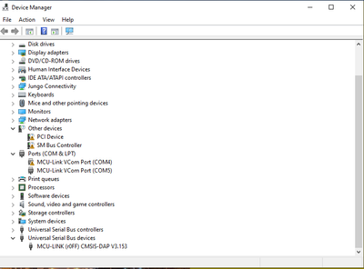

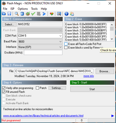

waqar6414

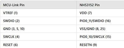

Hello, I am attempting to flash the demo program (for resistance measuring) onto the NHS3152 soldered on a custom PCB using Flash Magic with MCU-LINK, but I am encountering issues during the flashing process by SWD and ISP modes. Below are the details of my problem.
NHS3152 soldered on PCB and connected to MCU-LINK by SWD probe (J6)
The wiring of MCU-LINK (J6) to NHS3152 is as follows:
Flash magic screen settings:
Error details:
Power supply to NHS3152:
I tried to follow Arduino as ISP + Flash Magic don't work on NHS3152but it didn't work since the method relied on LPC-Link 2 instead of MCU-Link.
I would greatly appreciate it if you could look into my issue and assist me in resolving it. Thank you

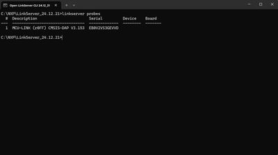

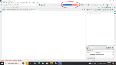

waqar6414
Hello Daniel,
Thank you for your guidance. I was able to successfully create a program for resistance measurement without any errors. However, I am now encountering a persistent debugging error.
Initially, I was able to flash firmware (e.g., app_demo_dp_blinky) using LinkFlash without any issues. However, I am now consistently facing the same error, both in LinkFlash and MCUXpresso IDE. The pin connections remain unchanged and are connected correctly as before.
I would appreciate it if you could help me troubleshoot this issue. Please refer to the attached screenshot for more details on the error.
3,714 Views
Daniel_Gutierrez
Hello @waqar6414, Good Day!
Please try selecting the "Wirespeed (Hz)" specifically. A speed of 4000 Hz has worked for me using the SWD protocol as well.
If you keep having trouble, please consider trying flashing with the "GUI Flash Tool" of MCUXpresso. Please refer to the configuration shown below.
In order to be able to flash the NHS3152 please make sure it is being correctly supplied with power using the battery.
My best regards,
Daniel.

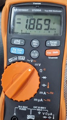

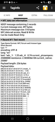

waqar6414
Hello Daniel,
Thank you for your guidance as it worked well, and I was able to successfully flash my resistance measurement program to the chip.
However, the chip is currently reading an incorrect resistance value of approximately 25kΩ, while the actual connected resistor is 10kΩ. Could you please review the attached code to help identify where the issue might be? I’ve also included a screenshot of the resistance reading for reference.
Looking forward to your insights.
Resistance Code:

As I can see on the picture you shared, the value obtained with the I2D peripheral (current) is exactly 25 uA  which would be the limit value of the corresponding range described in section 8 of the UM10876 document available in \release_mra2_12_6_nhs3152\docs. This happens because with a voltage of 1.33V (adc_1) and a 10k resistor, the current would be approximately 133 uA, which exceeds the limit of the range that has been set, so the returned value is the highest possible for that specific range.
Please refer to section 8.20 of the "NHS3152" document to find a detailed description on this matter, as well as some recommendations on combinations of resistors used with the different ranges of the I2D peripheral.
My best regards,
Daniel.

Thank you very much for your interest in our products.
The error you are getting is displayed when the Arm core could not be accessed, possible causes for this are:
  • The IC is not attached or not powered at all.
  • The IC has entered a low-power state, deep power-down state, or power-off state, where the SWD pins are no longer active.
  • The firmware image actively disables SWD access.
Please consider that when the firmware running in the NHS31xx IC decides to enter the deep power-down mode or the power-off mode, the SWD lines become inaccessible. Continuing or starting a debug session is then impossible. For addressing this problem and its solutions please refer to section 4.4 of the ''UM11153'' document, which can be found at ''C:\NHS31xx SDK Folder\docs\''.
Please make sure the chip is being correctly supplied with energy by checking pins:
VBAT(7) =  1.72 V to 3.6 V
VSS(8) = GND
You may refer to section 5 of the ''UM10876'' to find out more about power management.
I would like to point out that I have noticed some differences between your SWD pin distribution of the MCU Link and the one that is proved to work for debugging, please refer to this community thread Design Considerations for Debug - NXP Community and make sure the pin distribution you use sticks to the one described in the note, in which you will also find recommendations on required pull-up / pull-down resistors for some of the SWD pins.

waqar6414
Hello, Thankyou for your response. I tried to follow your guidelines, but none of them have worked for me.
Also, I have just realized that my MCU-LINK is not detected by MCU Xpresso after updating to the latest version. Although it is detected in device manager, and I believe it might be the reason for not responding of NHS3152 to MCU-LINK.
here are the details:
4,169 Views
Daniel_Gutierrez
Please consider that the window in which you find the ''MCU is not selected'' legend corresponds to the pin configuration tool of the IDE, the available debug probes can be found when starting a debug session or when using the GUI Flash Tool.
Please refer at the ''AN12328'' document available at ''C:\NHS31xx SDK Folder\docs\'' in which you will find a description of these and other flashing methods for NHS31xx ICs.
My best regards,
Daniel.
4,194 Views
