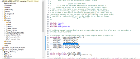

Hi takshpatel:
Sorry we don't have knowledge about NON-NXP products.
But for PN7160 reader, we have a basic demo for 15693 protocol. The host MCU is i.MXRT1170, LPC55S6x, LPC82X.
You can download sw6705 for more details.
https://www.nxp.com/downloads/en/software/SW6705.zip
You need to import this package into MCUXpresso IDE to run it.
As you can see, 15693 is supported in this demo
