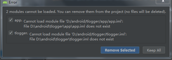

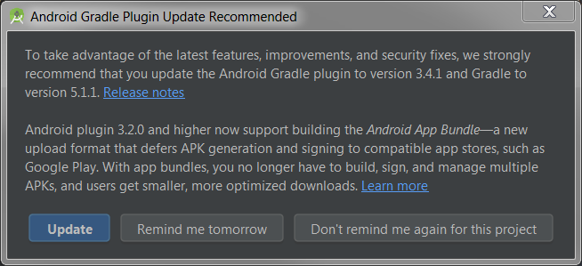

    I'm build Gradle with Android Studio 3.5. And I use Import project(Gradle, Eclipse ADT, ect) function to open this app demo. By the way, the SDK is release_mra2_11_2_nhs3152.However, When I build that, many error encounter. I never learn JAVA and Android Studio, so it almost kills me.
Here are some error message:
    ERROR: Connection timed out: connect
org.gradle.api.ProjectConfigurationException: A problem occurred configuring root project 'tlogger'.

driesmoors
If you are wholly unfamiliar to Android Studio and Java development, I suggest you to use the pre-built binaries path/to/sw/android/tlogger/Releases, or to you use the Google Play Store. If possible, of course.
The Android code in the SDK is provided to help you started, but is by no means production ready code. We are also unable to provide much support about this, as APP development lies outside our area of expertise - we're more into chips ;-)
That said; the code and project files are created using the older Android Studio version 3.0.1. The error you posted above refers to this: the project properties indicate the use of a specific gradle plugin for Android Student v3.0.1. You don't have this on your local machine, and the automatic retrieval fails.
The current stable version of Android Studio is 3.4.1. Normally, when opening the project, Android asks you to upgrade the gradle plugins.
If it somehow fails to do this for you, you can manually edit path/to/sw/android/tlogger/build.gradle and change the classpath to
classpath 'com.android.tools.build:gradle:3.4.1'
After picking up a more recent gradle version, building should continue and finish without issues.
Kind regards,
Dries.

liliao
Hi, Dires.
    I find two files missed in my project, and it's same in .zip file from release_mra2_11_2_nhs3152.
    Do you know how to solve this problem?
    Sincerely,
    Li.
5,314件の閲覧回数
driesmoors
Hi, Li,
Those files are files created and maintained by the development environment. They are not distributed - not even placed under version control - as they are regenerated by the build process.
You can just remove them. When the project is rebuilt, the missing .iml files will be generated automatically.
Kind regards,
Dries.
