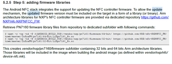

Hello Tomas,
we have recently integrate a PN7160 to our solution which will be used on Android but we found the FW of PN7160 is old and would like to upgrade the FW of PN7160.
Is there a way to update FW of PN7160?
We found your post here, but wondering if extra hardware kits are required. https://community.nxp.com/t5/NFC-Knowledge-Base/PN7160-FW-Update-via-MCUXpresso/ta-p/1793516
Thank you.
Leo
36 Views
danielchen
Hi  LPCRun:
Yes, the firmware for PN7160 can be updated.
For MCUXpresso projects,  just as the post mentioned,  it is updated via a Host MCU, LPC55s69.
For Android OS, firmware update is also supported.
Please refer to AN13189 for more details
