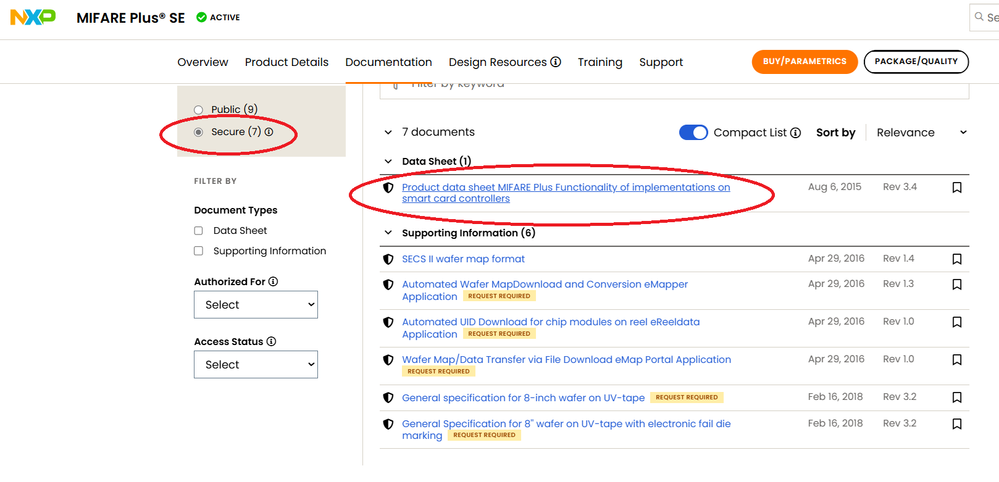

I have a new card(Mifare PLUS SE).
I have got 5180 board sdk kit(OM25180FDK).
I ran NXP MFC Cockpit program.
I had PowerOn(RF Fleld On and Activate Layer3).
So I try get version cmd (0x60 or 906000) and return value is 0x0B.
I want get version and perso commit and switch from sl0 to sl1.
I need to know the necessary APDU commands explaining how to personalize it and how to switch from SL0 to SL1.
or Can I get switch sl1 change program.
help me plz.

The information is in the full datasheet. Please download the full datasheet for details.
