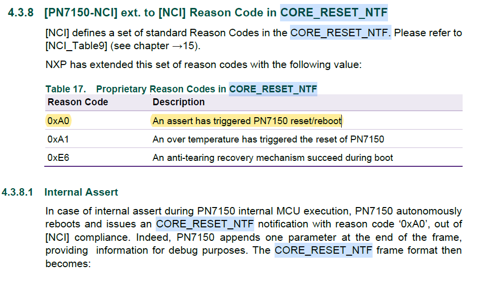

I am using NXP PN7150 for my project, In that, I have faced No RF field generation.
While checking it's debug logs i got CORE_RESET_NTF from PN7150 after start discovery command.
Whole notification :
NCI >> 21 03 09 04 00 01 01 01 02 01 06 01 (Start Discovery)
NCI << 60 00 06 a0 00 00 00 00 00 (Core reset notification)
As per PN7150 User manual UM10936(4.3.8) i find the core reset reason.
An assert has triggered PN7150 reset/reboot
Does it mean that PN7150 got damaged ? if not how do i recover it ?
Can i know the possible reason of this issue ?

Hi @JagirMehta ,
Thanks for the information!  The above trace shows EEPROM memory corruption issue, confirmed then by the CORE_RESET_NTF  when starting the discovery.
See UM10936 §10.3 for more details about this EEPROM memory corruption issue.
Unfortunately there is no way to recover from this issue. Sorry for the inconvenience that has caused.
