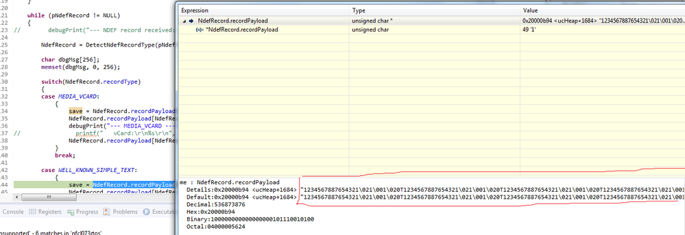

In NdefRecord.recordPayload multiple messages from the phone all are in one structure. If I want to receive 22 messages of 16 bytes all messages pull in one NdefRecord.recordPayload
This is the first message

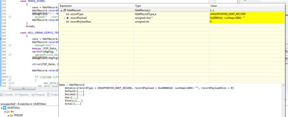

This is after the pointer goes beyond the memory allocated to the structure
All data that does not fit into the structure memory recordPayload is lost and library handles it how "Unsupported NDEF record, cannot parse", after this an HardFault error may occur due to improper memory access

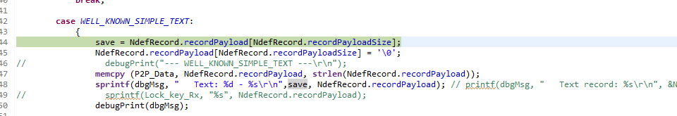

And its structure overflow after several NDEF messages
