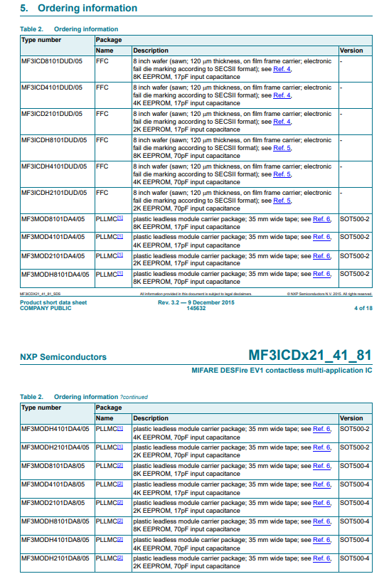

As the title。I get two type of smartcard named MF3ICD2101DUD/05 (D21) and MF3D2201DUD (D22),when I use the NFC reader to communicate with them,how can I distinguish witch one is the D21 and witch one is D22 ? can I read any used data from the NFC tags ? Thanks

Jonathan_Iglesias
Dear 涛 梁,
Hope you are doing great, could you please confirm to me the second part number, I am not able to found any information of this in the public web page nor in the systems we use.
MF3D2201DUD this one
in the ordering information of the data sheets you can found the versions and not one with the MF3D2201DUD  number.
please confirm this to me  to check this question.

tony_liang
thank you very much,to know more information of MF3D2201DUD,please visit this website below:
MIFARE DESFire EV2 2K|NXP
and MF3ICD2101DUD is descripte as below
MIFARE® DESFire EV1非接触式多用途芯片|NXP

Jonathan_Iglesias
Dear 涛 梁, my apologies got confused on the versions of the DESFire, the comparison you want is between EV1 and
EV2  we have a full comparison document, Feature And Functionality Comparison Between MIFARE DESFire EV1 And EV2 (1.2) (AN3387), since there are a lot of differences I would recommend that you check this document, this document is in our platform Docstore, please sign in and download it, this will request that you previously have signed an NDA(Non-Disclosure Agreement) with NXP. if you do not have any NDA signed please contact one of our distributors in order to sign one.
