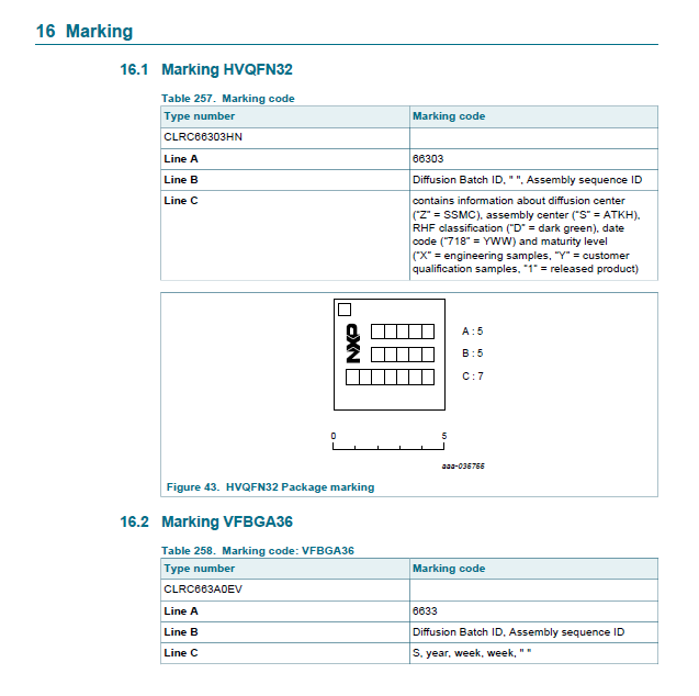

How to decipher the marking of the CLRC 6301, "02 11", "ZSD 822" microcircuit?
The suspicion that this is a completely old microcircuit and differs from the new microcircuits.

estephania_mart
You can find the marking information in the Datasheet of the device, you can check it in the chapter 16 Marking
Hope this helps,
Estephania
