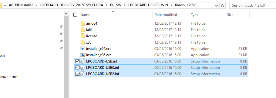

eyallasko
Hi Lukas, Jorge,
Same problem here.
Installed latest cockpit (3.7.0) with PNEV5180B on Windows 10.
Disabled driver signature reinforcement as Jorge suggested and right click>install the 3 *.inf files in C:\nxp\NxpNfcCockpit_v3.7.0.0\ABENDInstaller\LPCBOARD_DELIVERY_20160729_FLORA\PC_SW\LPCBOARD_DRIVER_WIN\libusb_1.2.6.0  (LPCBOARD-USB.inf / LPCBOARD-USB0.inf / LPCBOARD-USB2.inf).
In device manager I only see virtual com ports, not libusb entries as mentioned in the quick start guide (AN11744 pg 15).
Installed program list shows (filtered for NXP)
NFC Cockpit show "Disconnected"...
I also tried to re-program the board by momentarily shorting SW200 when powering the board.
However I got an error message when dragging-and-dropping bin file on the mass storage device (should I keep SW200 shorted after power up in order to copy ?)
btw, what is the firmware version that the board comes programmed with ?
Any advice ?
