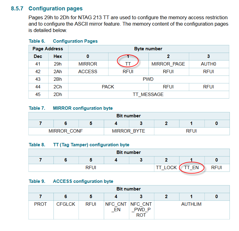

How do I configure my NTAG 213 TT tag? I would like to enable the tag-tamper feature.

I have a ntag213 TT without tamper enabled. How do I enabled tamper feature?
How should 2Ch data look like to enable the tamper function?

Hi ,
You have to use TT_EN bit to enable or disable the tamper feature. Please refer to the following for details.
Kan
