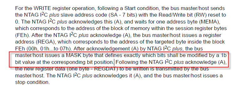

We try to figure out how can we use MASK byte during writing command, but there is no example in the datasheet.

Hi Ledwin Guo,
Please refer to the following for details.

Dear Kan.
Is there any example to show what different if I set difference MASK data? That made us very confused.
