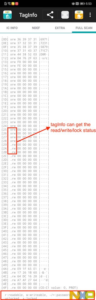

I found that when i use the app "tagInfo" on a cellphone, i can get the locked/unlocked status for each block clearly as below. If I would like to get the locked/unlocked status information for every block by using my own reader,how can i achieve this. I have been go over the product data sheet of ICODE SLIX2, and did not find any supported command to obtain this information, could you tell me the right way to achieve this(I have been achieved most of the mandatory and optional commands on my own reader for ICODE SLIX2 tag). Thank you very much!
