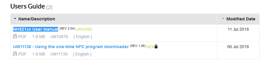

     Of all the 12 GPIOs in NHS3100, not every one can be configured as open-drain GPIO, you can read and check IOCON register, and you will find that only 2 pads for I2C can be configured as open-drain GPIO.
see um10876.pdf, please!
---IOCON register descriptions (base address 0x4004 4000)
You can download it from the link:
NHS3100: NTAG SmartSensor with Temperature Sensor and Digital IOs|NXP
Have a nice day!
