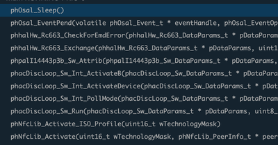

I'm using 3rd party MCU, connected to the CLRC663, and did the NullOs porting of the library "NxpNfcRdLib_07.05.00_20220527" and the issue I face is:
For polling ISO14443B tag, from time to time, the NxpNfcRdLib gets stuck in the infinite loop, waiting for the "event" from the CLRC663.
Namely in the
phOsal_EventPend(), where a while(1) loop is, waiting for an external IRQ from the CLRC663, that breaks this loop.
Unfortunately, if you are "lucky" the CLRC663 never gives you the required IRQ, and the phOsal_EventPend() waits indefinitely since it's called with the
PHOSAL_MAX_DELAY parameter.
If you are interested, this is how the call stack looks like:

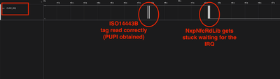

And this is the CLRC_IRQ pin:
The issue happens typically when the NFC reader (custom-based with the CLRC663) is not perfectly aligned with the ISO14443B tag antenna.
Based on the call stack, the CLRC663 can get the ATQB (answer to REQB), and then the library gets stuck when performing the ATTRIB command and waits for the response from the PICC.
Here I assume, the CLRC663 can't properly decode the correct answer (since it typically happens when the antennas are not properly aligned) and it just waits indefinitely (PHOSAL_MAX_DELAY) for the answer, that never comes.
To solve this, I'm gonna modify the library to remove this indefinite wait, so a "normal" timeout of the while loop can happen...
(or lowering the PHOSAL_MAX_DELAY)
