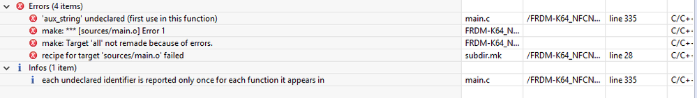

Thanks for your quick response. I believe PN 7120 is similar to PN 7150. But in the link that you've provided, you have used KSDK V2.0 and I'm using V 1.3. So, I was wondering what changes do I have to do in the code w.r.t the change in version. Also, have you used the following main.c program to detect the MIFARE RFID tags?
https://github.com/ErichStyger/mcuoneclipse/tree/master/Examples/KDS/FRDM-K64F120M/FRDM-K64F_PN7120_...
Additionally, I am planning to store this printed data on an SDcard mounted on K64F. I referred to one of your tutorial to do the same but this is with using Processor Expert and I'm not using Processor Expert. I also referred to Jorge Gonzalez's tutorial that is done without using PE but uses an older version of KSDK(V1.2). As I'm trying to follow it I am facing errors (screenshot attached) and would be glad if you could help me resolve those errors. Whenever I add the aux_string declaration(error 1) the number of errors increases even more.

BlackNight
Hi Shruti,
moving between SDK v1.x and v2.0 is non-trivial because the API changes between the two versions are really large. The SDK v2.0 documenation provides a porting guide how to move from 1.x to 2.0, and this alone is not easy to do. In short, I recommend that you start with the 2.x SDK and do not do start a new project with the 1.x.
