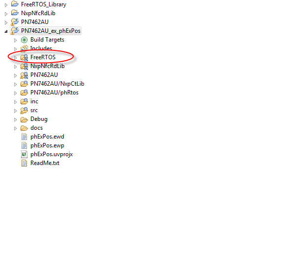

Hi All,
I have a couple of questions regarding PN7462 with 160KB.
I want to use PN7462 with TCP/IP and an RTOS if needed.
1. Do I need to use an RTOS to make use of TCP/IP on integrated Cortex M0 ?
2. If I need  an RTOS, do I need extra storage space or flash on board to support this. How much ?
Gun
1,929 Views
Kan_Li
Hi Gun,
Actually you don't have to worry about the RTOS, PN7462AUPspPackageFull-v04_05_00 already included FreeRTOS in the package, you may directly invoke the system API from the library.Please kindly refer to the following for details.
for the above example, the total image size can be referred as below:
There should be enough space left for the your application code.
Please also note PN7462 doesn't contain an embedded Ethernet module, you have to use an external module which can be connected with SPI or I2C port.
Kan
